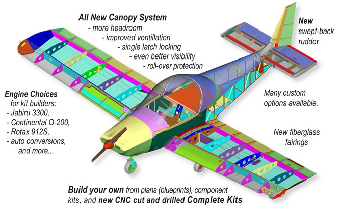

I'm brand new to ViaCAD (and somewhat new to CAD in general). I wish to model aircraft parts which are constructed in sheet metal. I wish to build up a 3D model of various Zenith aircraft - something along the lines of the below image:
http://www.zenithair.com/zodiac/ch650/gif/features.jpg
with each major part within the model being dimensionally accurate.

ViaCAD is an excellent way to model the Zenith. You can model every part of the aircraft very accurately using a variety or combination of methods. Sometimes you may have to try different approaches to see which works best for the component that you are modeling.
For the sake of accuracy, if I were modeling something I truly wanted to build, I would do every thing as a solid. I would only use surfaces for when I'm doing concept modeling, such as just trying to see how something would look or to create illustrations. Surfaces do not have volume or depth. If modeling a wing skin, for example, the thickness of it will be important to your dimensional data. Also, having it modeled as a solid (even though a very thin solid) will give you the volume information so that you can calculate the weight or density of that part.
