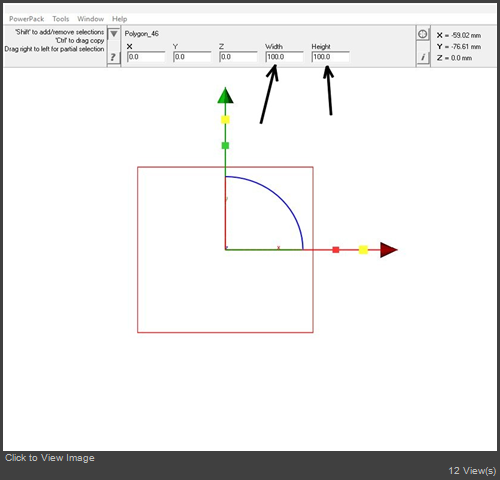

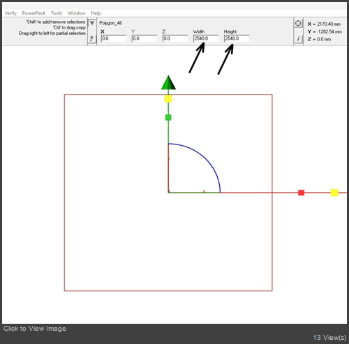

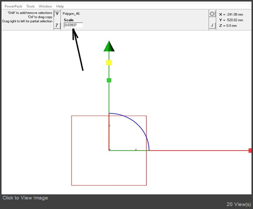

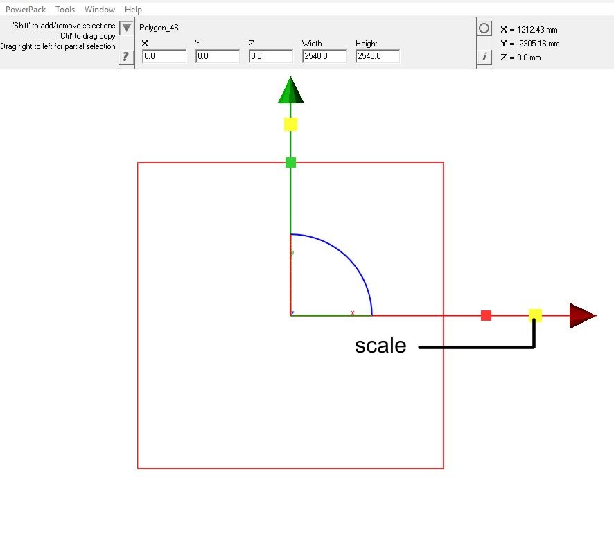

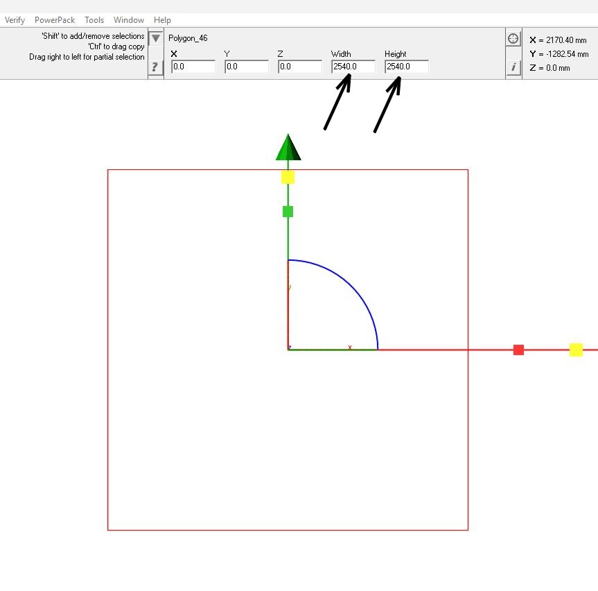

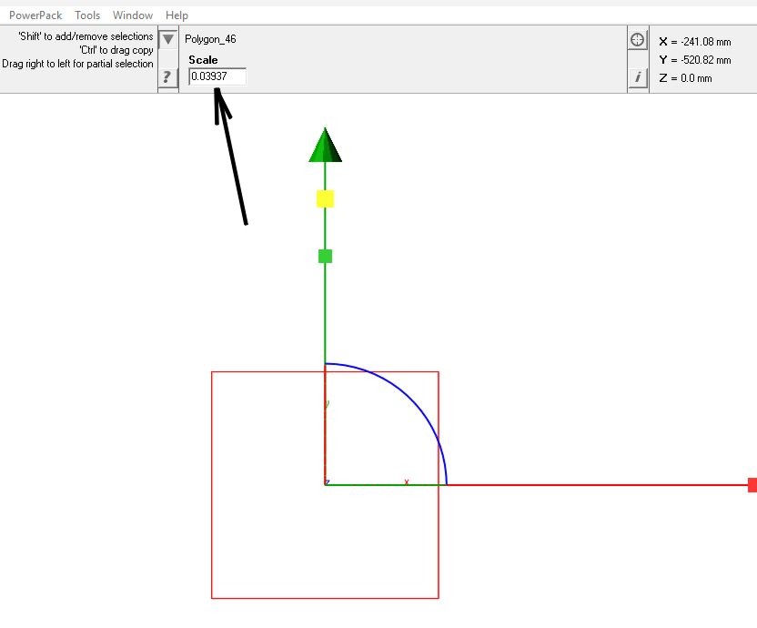

Hi,
If you import a file while the dimensions are Inches it's easy to scale with your gripper to use the scale 0.03937
Regard, Theo
